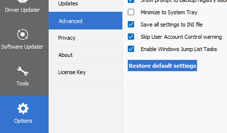

Just for completeness, or in case you don’t want to stop the browser background running:
The way to get that message back in Custom clean is to reset ALL of your settings to their defaults.
There is a button to do that in Options> Advanced
