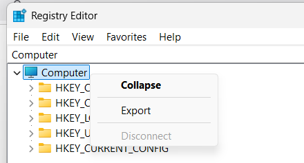

PS. To backup the entire Registry open regedit and right-click on ‘Computer’ then select ‘Export’

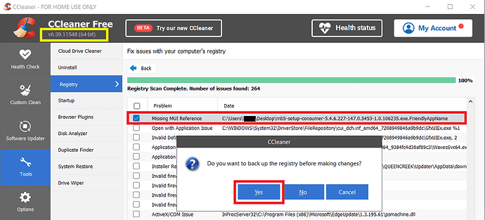

The registry cleaner is working as expected with my CCleaner Free Portable v6.39.11548.

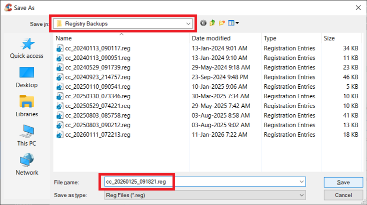

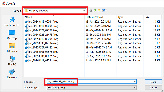

As a test I ran my v6.39.11548 registry cleaner today to clean up one entry that was pointing to a Malwarebytes v5.4.6 installer I originally saved on my desktop, and after saving the cc_20260125_091821.reg file in the location I selected (i.e., in a folder I had previously created at C:\Users\<myusername>\Documents\PC Troubleshooting\CCleaner\Registry Backups) …
… the cc_20260125_091821.reg file contained:
Windows Registry Editor Version 5.00
[HKEY_CURRENT_USER\Software\Classes\Local Settings\Software\Microsoft\Windows\Shell\MuiCache]“C:\Users\ljmac\Desktop\mb5-setup-consumer-5.4.6.227-147.0.5453-1.0.106235.exe.FriendlyAppName”=“mb5-setup-consumer-5.4.6.227-147.0.5453-1.0.106235.exe”
After rolling back to CCleaner v6.39.11548 did you ensure Settings | Advanced | Show Prompt to Backup Registry Issues is ENABLED, and if so are you sure you’re looking in the correct folder you selected to save .reg files created by CCleaner v6.39.11548?
