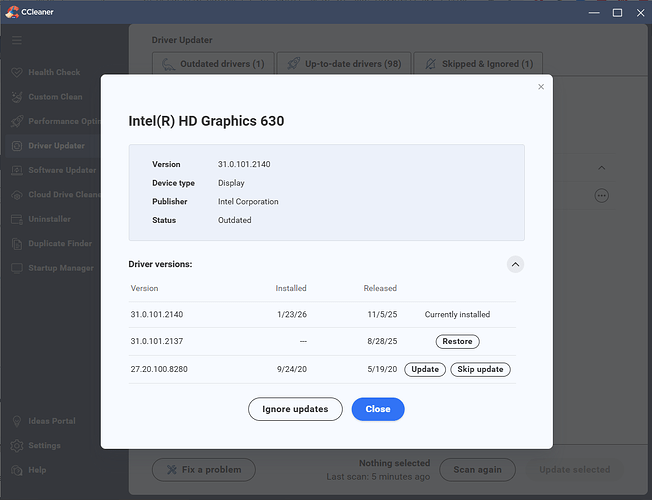

Hi,
Current Display Driver Ver. is 31.0.101.2140 from 05/11/2025.
Proposed update for Display Driver Ver. is 27.20.100.8280 from 19/04/2020.
This looks odd.
Please advise.
Thanks!
Harel

Hi @Laurence_CCleaner,
Okay, but yet, I’m already using much newer versions for long time:
  • 31.0.101.2140, installed on 2026-01-24 (quite new)
  • 31.0.101.2137, installed on 2025-10-17
  • 31.0.101.2135, installed on 2025-04-01
  • 31.0.101.2130, installed on 2024-09-08
  • 31.0.101.2128, installed on 2024-06-01
  • 31.0.101.2127, installed on 2024-02-04
  • 31.0.101.2125, installed on 2023-06-18
  • 31.0.101.2121, installed on 2023-04-07
  • 31.0.101.2115, installed on 2022-12-31
Therefore, returning to the 27.20.100.8280 version dated 2020-04-19 still appears questionable, and especially in this case, in which the gap is huge.
In addition, 31.0.101.2140 is proposed and installed by Intel® Driver & Support Assistant.
Unfortunately, this is not the first time drivers update proposals found incorrect, and corrected only in the next CCleaner version.
It might be worth taking another look at this.
Thanks!
Harel
