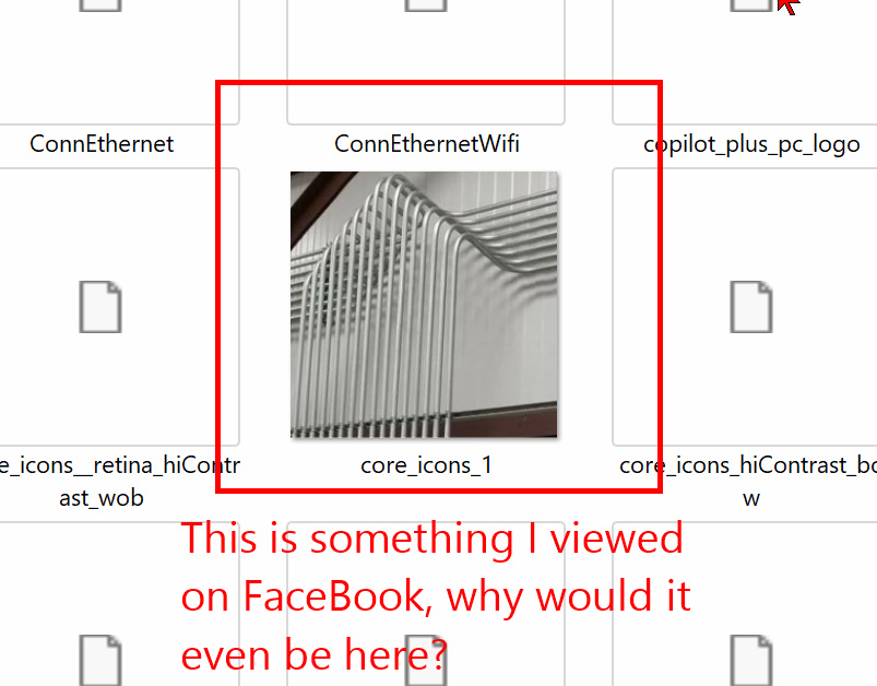

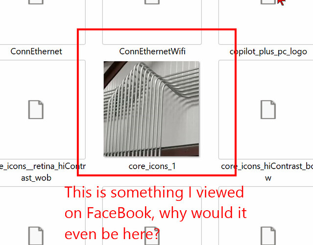

Just tried it again, tweaked the search for photos only. None of the photos I deleted showed up that I wanted to recover, got a bunch of files that couldn’t be opened. pics of flags and other junk like stuff I viewed on face Book,. some were shown as icons and when I clicked to open it, got" looks like we don’t support this Format". It included some photos never saved. This Recuva is not doing what it is supposed to do.

Images do get automatically downloaded onto your drive by things like Facebook, and Amazon, and may other places, and then they get deleted again when you leave.
Your browsers may also save files and images from webpages onto your drive, particularly if you have the browser set to pre-load or pre-fetch web pages.
You might not know that any of that was going on all the time in the background, but Recuva finds the file(s) because it was there and then it was deleted.

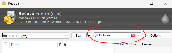

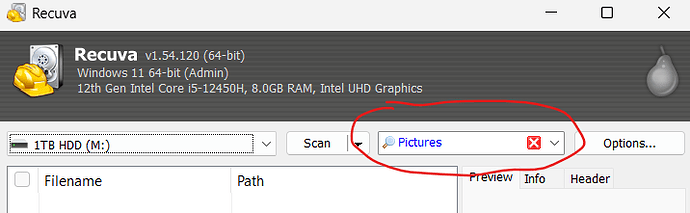

Rather than searching for ‘images’ try using Advanced Mode and searching for the specific image filetype that you want to find eg. search for *.jpg and/or *.jpeg, and/or *.img etc.
Drop the arrow next to ‘Filename or Path’ select ‘Pictures’; then click the word ‘Pictures’; you will be given a list of common image filetypes, you can remove any that you don’t want Recuva to search for:

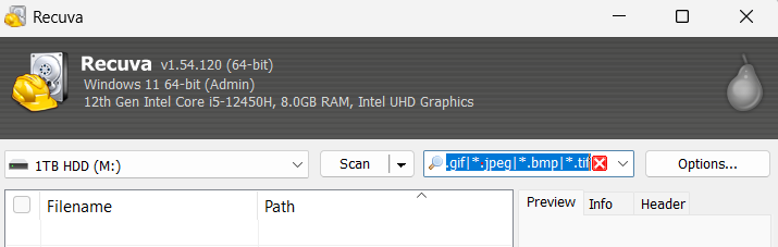

Note that rather that doing it that way you can just type in the filetypes you want to search for separated by a pipe (vertical bar).
For example entering:
would search for deleted image files of those 4 filetypes only.
