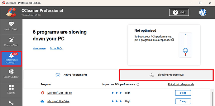

I don’t use CCleaner Pro so I’ve never used the Performance Optimizer feature, but you might want to check if this feature is putting any of your applications to sleep to save system resources. There seem to be quite a few CCleaner Pro users complaining that their Microsoft 365 / Microsoft Office programs don’t launch correctly and the culprit is often Performance Optimizer.
I still don’t have sufficient privileges in this forum to embed images in my posts, but the May 2022 CCleaner Knowledge Center article Our CCleaner 6 app is out now with a new, patented Performance Optimizer and improved Software Updater has an image of the Performance Optimizer window that shows the “Sleeping Programs” tab. Perhaps @nukecad could post an image of what the Performance Optimizer window (and the Sleeping Programs tab) looks like in the latest CCleaner Pro v6.28.

Here’s the image from that May 2022 CCleaner article I was referring to:
