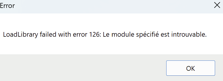

I got this message after driver updates with CCleaner7; software such as DaVinci Resolve doesn’t work but I got also this message with other usual software…
Is there a solution? Thank you

Hi Laurence, I roll back 11 drivers but unfortunately that doesn’t work. Same message with DaVinci Resolve immediately after launch and also displayed sometimes I don’t know why… Is there any solution or bypass? Thank you
@JPM, if rolling back the drivers hasn’t resolved the issue, this indicates it’s unrelated to the driver updates performed by CCleaner — rolling back restores the original drivers, so any persisting problem points to a different cause.

1- the message “LoadLibrary failed with error 126” is also displayed (as an example) with “OpenShot Video Editor” application and sometimes with “AMD Software” without launch of any specific application, so I guess an AMD driver doesn’t work well (AMD Radeon™ 880M Graphics or AMD Ryzen AI 9 365 w/ Radeon 880M…)
2- In CCleaner, “AMD Radeon™ 880M Graphics” driver has been updated the day I launched CCleaner Driver Updater after buying it (17 march) but it does’n’t appear in the list of drivers I can restore, that’s strange.
Do you think that can be the source of problem? and how is it possible to solve it?

@JPM, Thank you for providing those details.
You raise a good point. Since the error is appearing across multiple applications that rely on your AMD graphics hardware (DaVinci Resolve, OpenShot, and AMD Software itself), this does suggest the AMD Radeon 880M Graphics driver may be the source of the issue.
I also want to look into why that driver isn’t appearing in your restore list, as it should be available if it was updated through Driver Updater on 17 March.

Our development team has reviewed the logs and confirmed that the backup for your AMD Radeon 880M Graphics driver, unfortunately, failed during the update process, which is why it doesn’t appear in your restore list.
I’d recommend trying the following steps:
Open Device Manager (you can search for it in the Windows Start menu)
Expand Display adapters and right-click on AMD Radeon 880M Graphics
Select Uninstall device
In the confirmation dialog, make sure to tick the “Attempt to remove the driver for this device” checkbox, then click Uninstall
Restart your computer — Windows should automatically revert to the previous driver that was installed before the update
If for any reason Windows doesn’t restore a working driver after the restart, you can manually download and install the previous version of the AMD Radeon 880M driver directly from the AMD support website.
Please let me know if you have any issues?
