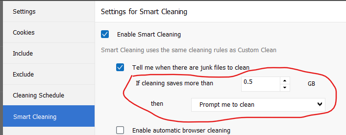

If Smart Cleaning is running then, depending on how you have set it them it may open a notification if there is junk to clean, (A Windows startup does create junkfiles).

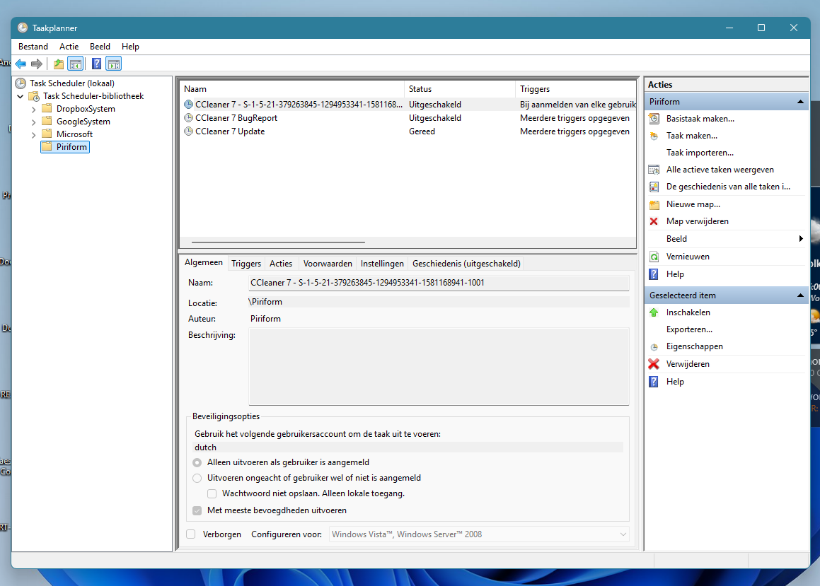

There are also some scheduled tasks such as once a day checking if there is a CCleaner update, and once a day checking if there are any error logs to send. You should only see those actually running in the background for a couple of seconds and most people would never notice them.
Also check “Task planner’ if there’s a Pitform AutoStart option..
