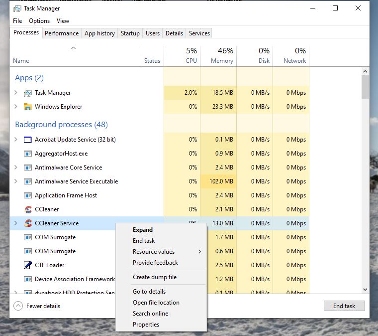

There is always ‘End Task’ in Task Manager. Of course it will just start up again at some point (unless you delete the trigger that is starting it).
I’ve gone back to the 6.39.11548 as I hated in v7 there is zero way to exit it, so it doesn’t run constantly in Task Manager except for being forced to End Task it.
It now won’t even work without a constantly running Service too.
