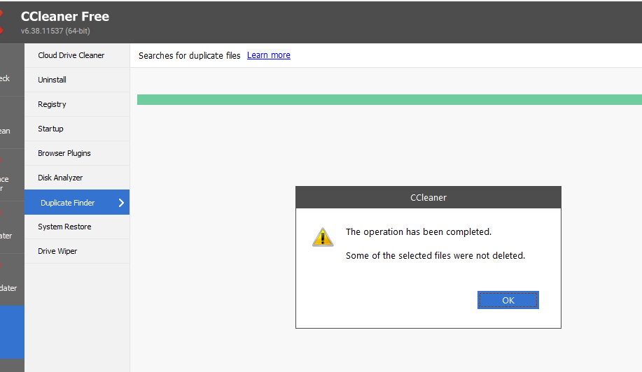

CCleaner won't delete .emi files
I’m using Duplicate Finder to delete a large amount of duplicate files on an external backup hard drive. But CCleaner won’t delete .emi (email) files. Anyone know why? Appreciate your help.
The Delete button will be greyed out until you select some to delete.
If you have selected the ones that you want to delete and CCleaner can’t do that then do you get an error message?
I would suspect that it’s a permissions issue.
eg. maybe the files are read-only, or actually stored on the email server rather than your machine.

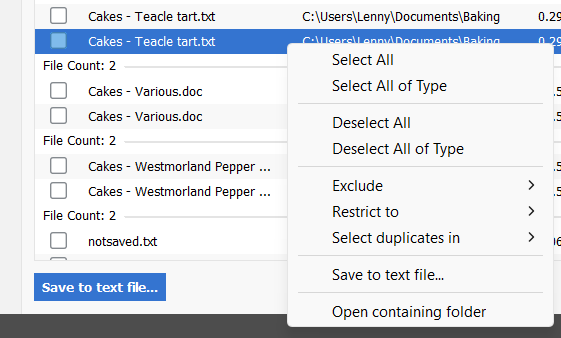

PS. You can right-click on any of the results and the context menu that pops up gives you various extra options for selecting things, etc.

There is no “open file location” option when I right-click on an .eml file in CCleaner or in Windows File Explorer. I can delete any and all .eml files in Explorer but I want to keep one of each .eml file and I don’t think there’s any quick way to get a list of duplicate files in Explorer. That’s what CCleaner seems to be very good at doing and why I think it should allow .eml files to be deleted no matter their properties or settings. It’s up to the user to decide which files to delete when it comes to any other file type I’ve come across.
Apperciate any other assistance.
It will be Windows that is preventing deletion, not CCleaner.
It is interesting that you say there is no ‘Open containing folder’ for your duplicates though.

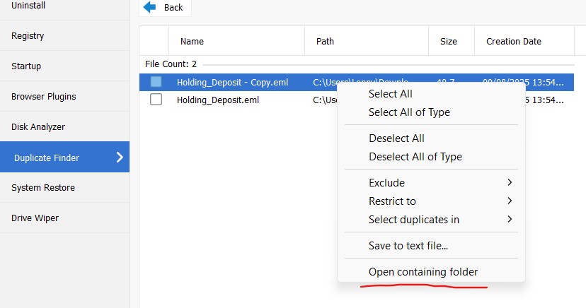

I just saved an eml and created a copy here and right-clicking on it the option is there:
I can also delete the copy from CCleaner without a problem.

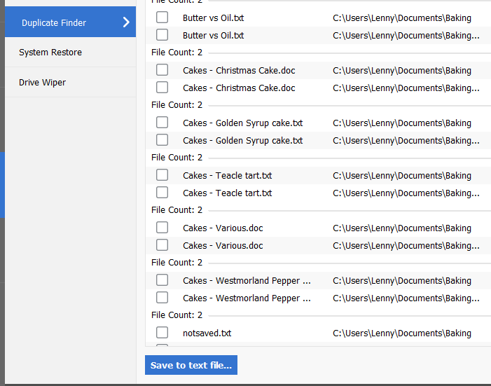

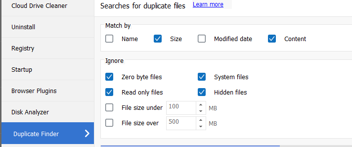

Could you post a clip of your search options, similar to this:

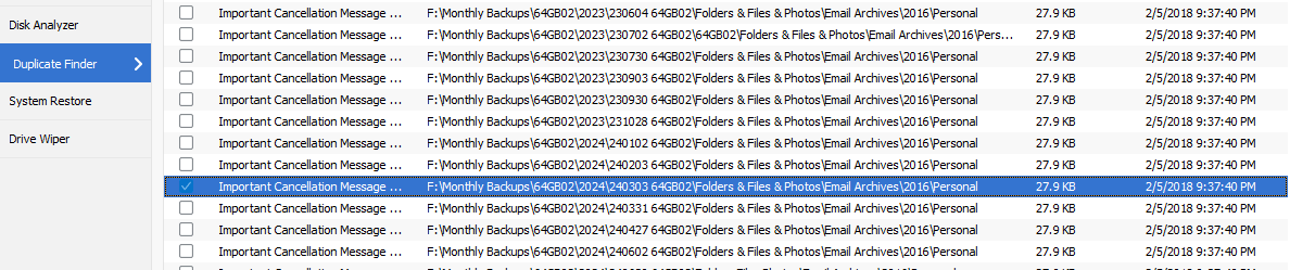

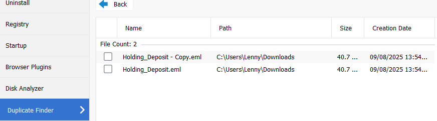

and a clip of one or more of the problem results, showing the full file and full pathnames:
Here are those screen shots. I can open the “open container folder” but it takes me to this screen and I have no idea where to go from there.
I tried to upload the other two screen shots but apparently new users like me can only upload one shot per reply. I’ll try to upload the others in two different replies.

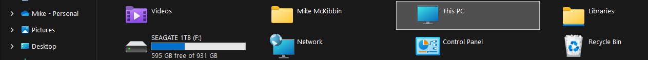

FYI, the Seagate drive is my backup hard drive and where these .eml files are located.
Here is the file and folder location for the .eml files.

The screenshots themselves are helpful.
I see that you were searching on name.
It’s not usually the best way as different files, in different folders, can have the same name.
(eg. ‘Photo1.jpg’ in one folder may be from a wedding, whereas ‘Photo1.jpg’ in a different folder may be a holiday snap).
It’s better to search for ‘Contents’ (which also sets ‘Size’) so that it only finds exact duplicates.
I’m fairly sure I may know now why CCleaner cannot delete these files.
I see that these are duplicate files in monthly backups, and from the look of the names you appear to make full backups rather than incremental backups.
Is that correct?
eg. The one that is selected is a backup made on 3rd March 2024 of an email archive from 2016.
You have many copies of it there, a couple of years worth at least.
It doesn’t show there but I suspect that these backups may be in a compressed format, maybe a zip format, if so then that will probably be why CCleaner won’t be able to delete them.
A zip or similar compressed file is one file containing lots of other files in a compressed format.
CCleaner can only delete a whole file, ie. it can’t delete just certain contents of a zip or other compressed file it could only delete the whole zip and everything it contains.

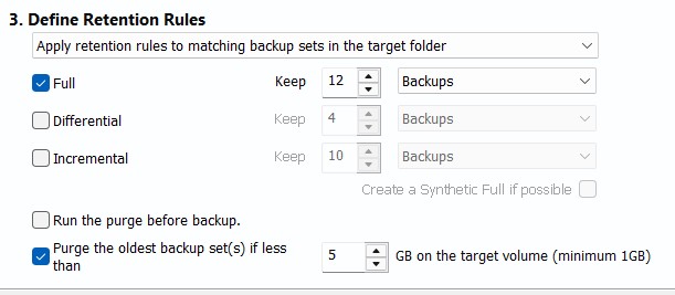

  • For my main backups I use Macrium Reflect to make whole drive images.
    (It takes about 6 minutes to do a full image backup of this Win 11 laptop to an external HDD, my very old Win 10 laptop it takes about 20 mins because that one has a 12 year old so much slower CPU)
    It has a setting to only keep so many backups and so will delete the oldest one automatically as it makes a new one.
    Alternatively (and additionally) it can be set to delete the oldest backups if the drive is running out of space.
You can see there that I have it set to only keep 12 backups, once I had done 12 then as a new one is made the oldest is deleted.
Check whatever backup software you are using, it may have similar settings for how many backups to keep.

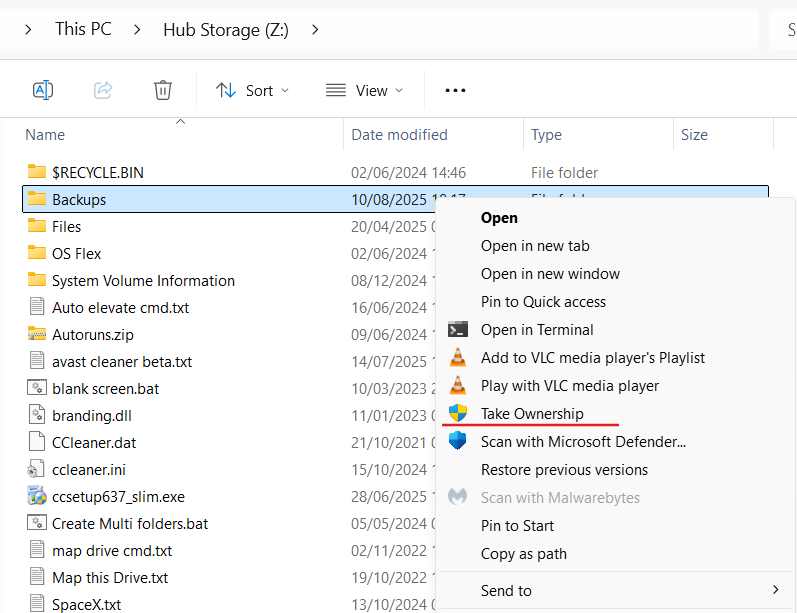

The fact that you are saving them as copy/paste gives me another idea of what may be happening to prevent the deletion of the eml’s.
I’m guessing that you have changed computers over the years, probably more than once, and some of those copy/paste backups will be from different computers.
Files saved on, and copied from, one computer will have the user account you were using on that computer when you created the file as the ‘Owner’ of the file.
That means that if/when you try to delete that copy from a different computer it may refuse to do so because the user on the new computer does not have ownership of it.
I have come across it myself when copying files between my laptops and/or onto external drives.
If/when it happens to me then I ‘Take Ownership’ of the file, or the whole folder that it is in, and then I have full permissions to delete it or do what I want with it.
You can take ownership through Windows using Properties for the file, but I find that a faff, it isn’t always easy to do, and isn’t always successful.
Instead I add/use a “Take Ownership” option on the right-click context menu in File Explorer.
One click of that and I have full ownership of the file, so full permissions to be able to delete it.
This is from Win 11 where you need to use the ‘More options’ on the context menu to get to the added option. (if you have Win 11 then you’ll know what I mean).
Here I could Take Ownership of the ‘Backups’ folder on my networked drive and everything in it (It’s full of copy/paste backups similar to yours and from more than one computer)
Note - I’m using a fairly new laptop purchased a couple of months ago and I don’t recall having to add it to this particular computer, so I think it may now be included in Win 11 as a standard context menu item? (or maybe I did do it and I’m just getting forgetfull?).
If you don’t see such an option on your context menu then there are plenty of options out there to add one.
This is from the Windows 11 forum but it works in Win 10 as well:
https://www.elevenforum.com/t/add-take-ownership-to-context-menu-in-windows-11.1230/
This is a very simple one from Revo:
As I say there are plenty of others out there, you can also find some stand alone apps to take ownership rather than adding it to your context menu.
