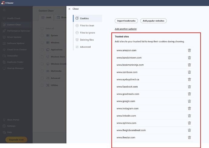

In the new CCleaner Version 7, “Keep Cookies” from trusted sites does not work (e.g. I log into NY Times site and preserve the site, but it logs me out after I clean).
ccleaner 7 > custom clean > settings > cookies > keep cookies from trusted sites > added [NYTimes]

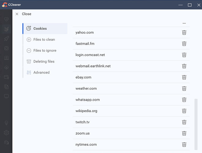

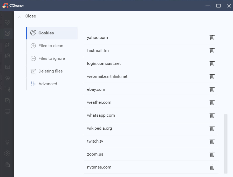

Here is a screen shot. Re-tested again today and can confirm Cookies are not being preserved despite being whitelisted.
@hmsccleaner,
Can you remove the www from these and retest to let me know if this resolves the issue for you.
Hello,
Yes - I can confirm that if I remove the “www.” subdomain prefix from the primary domain (use ~nytimes.com instead of ~www.nytimes.com), the whitelisted cookies I provided for this test are preserved.
