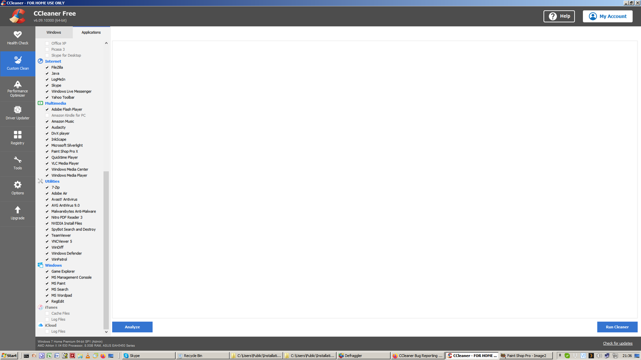

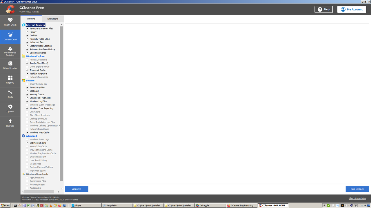

Here are screenshots of the options that I have selected (I use the same options for every version of CCleaner)
ccleaner-1.png (

I too have Windows 7 (Ultimate) SP1) and have just updated CCleaner to ver 6.11.10435 and the scan crashes towards the end, however, I've managed to get mine to complete the scan by unchecking TEAMVIEWER in the Ultilities section, something I noticed you have installed in your screenshots and yours is checked.

To confirm, there is an issue with CCleaner 6.11.10435 specifically relating to running cleans on TeamViewer, which (as per @NE0) can be temporarily worked-around (until we release a fix) for impacted TeamViewer users by unchecking TeamViewer under Custom Clean > Applications > Utilities:
