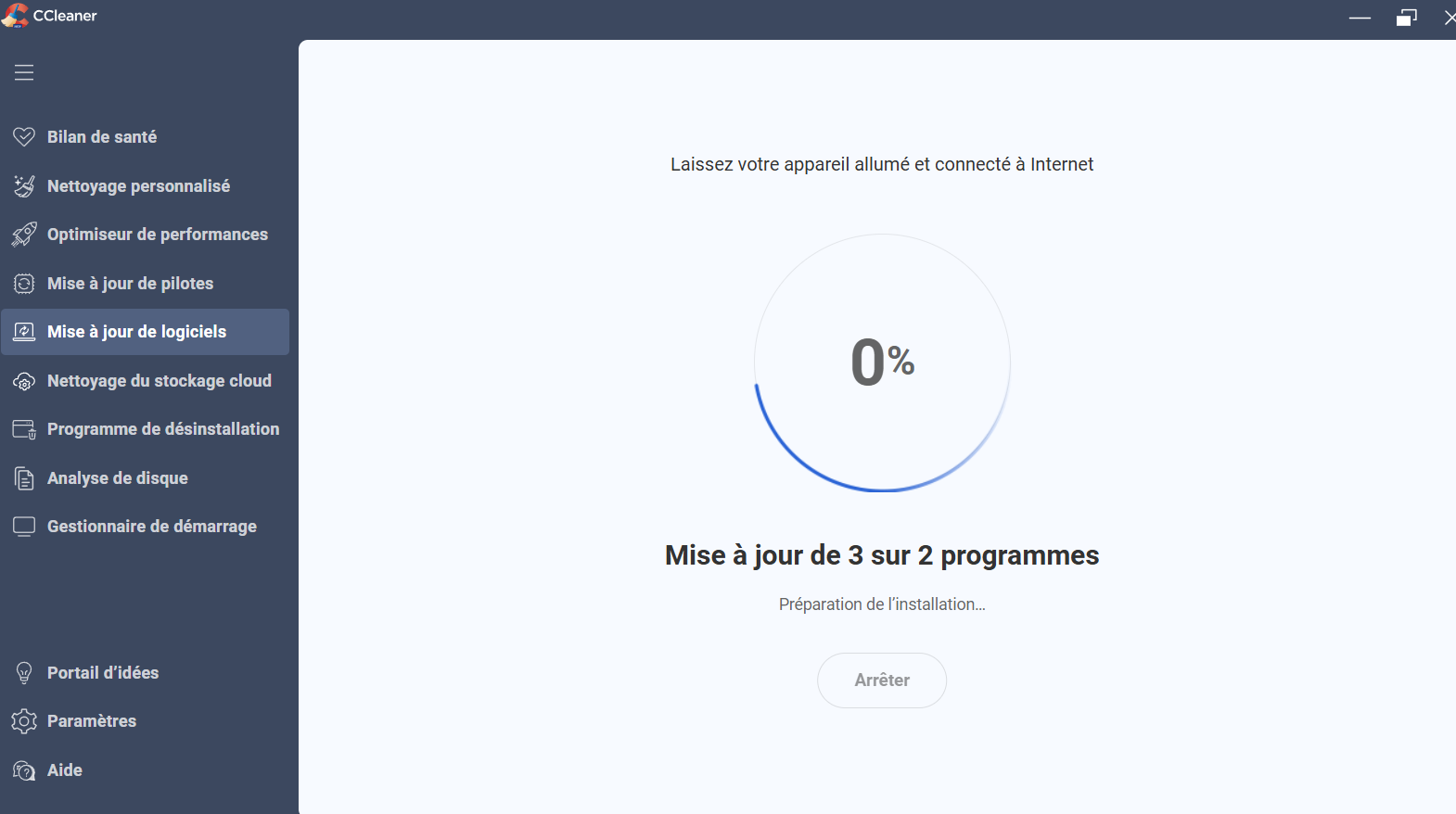

Bonjour,
J’ai installé CCleaner 7 et lancé “mise à jour de logiciel” mais ça fait 5 heures qu’il tourne en rond et pas moyen de l’arrêter. La touche “arrêter” est inopérante.
CCleaner is spinning around for 5 hours and impossible to stop it.
Quelqu’un peut-il m’aider ? Merci
Thanks for your help

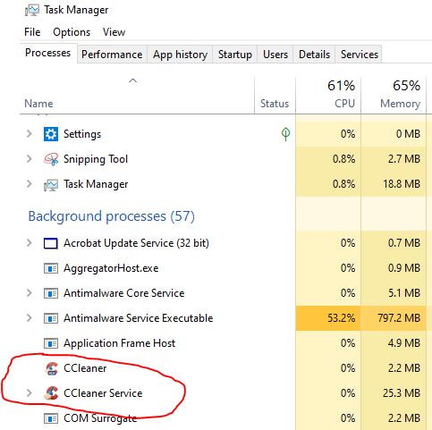

In your Windows task manager highlight CCleaner and select end task at the bottom of the window.

thank you for your answers,
Of course I closed it with Task Manager, but the problem is still here.
When I restart it, it opens in health checking, and is spinning around for hours.
For sure this new version does’nt work. I wonder if I should uninstall it.
Did you End Task on both CCleaner and CCleaner Service ?

I end both tasks CCleaner and CCleaner Service and restart it.
It seems it’s OK now.I will check again in few days. Il will not uninstall it for now.
