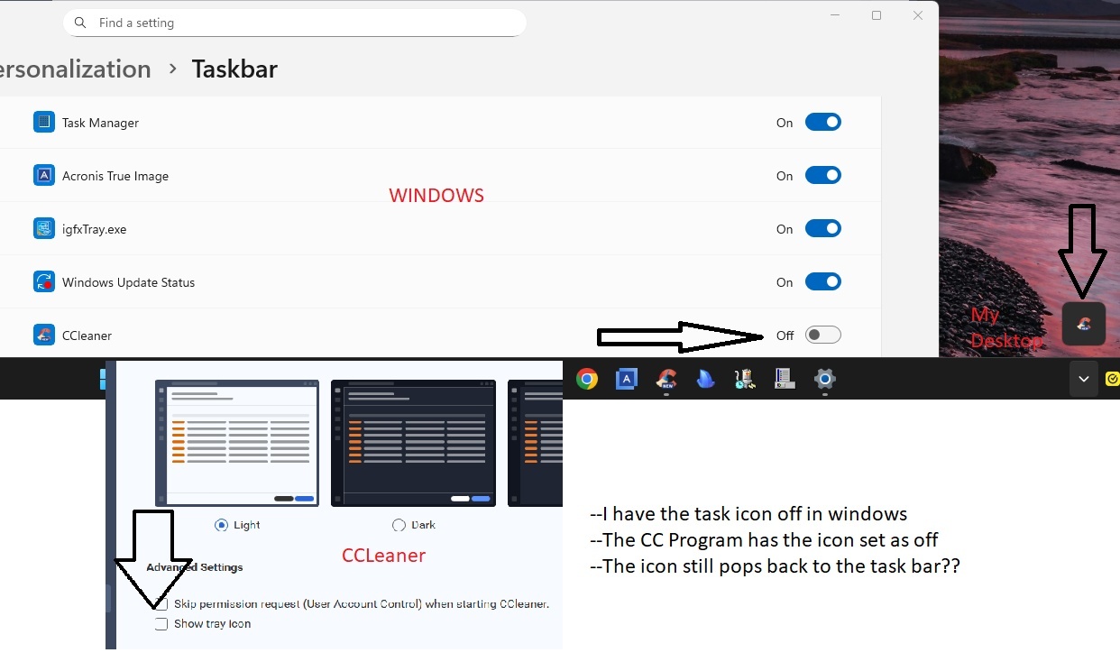

Not critical at all, but I’m curious if this is a bug that needs to be reported or corrected. I have all settings configured to avoid the cleaner popup-v7 in the taskbar, yet it still appears intermittently. It’s not a major issue, but I wanted to confirm. Thanks

The short of it is open task scheduler and set the ccleaner.exe/bg task to delay 30 seconds. https://windowsloop.com/how-to-delay-scheduled-task-in-windows-10-11/
Also that section of windows settings is only for hide in overflow or show on desktop, the problem your having is the icon is unopened

I’m wondering why the cleaner popup eventually appears as a tray icon, even though this setting is consistently turned off in both the Cleaner and Windows settings. Is this expected or normal behavior? If so, what causes it?
I would prefer that it not appear there, as that is my selected and preferred setting.
