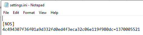

Yes it creates a settings.ini, but that is not much use if there is nothing in it ? Version 6.38, w10, do you have to do something else for it to write the settings out, rt does it just not work ?

āsettings.iniā ? It should be called āccleaner.iniā.

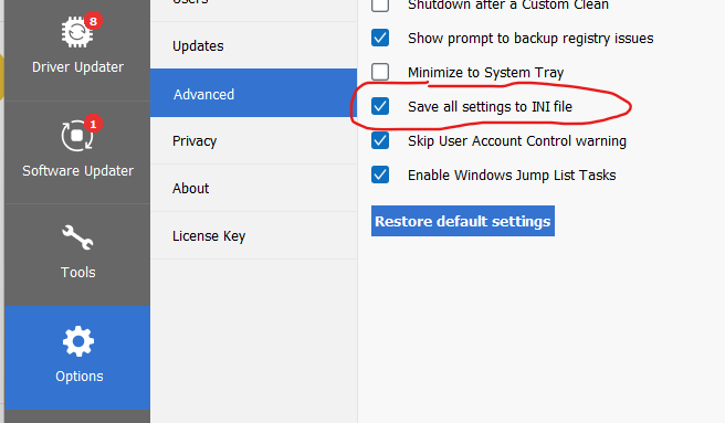

It is created using this setting and there should be a lot more information in it (my āccleanerāiniā file on this laptop currently has 307 lines and as you can see above is 16 KB in size).
You say that yours is only one line, could you copy/paste that line into your next post so we can see what it is?
I wouldnāt expect one to be there unless you have ticked the option that I screen-shotted above.
I donāt have that āsettings.iniā on this machine.
Iāll have to do some digging/testing to see if I can recreate it.
Iāll fire up my Windows 10 laptop later this afternoon and do some playing with the options/settings in CCleaner Free on that to see if I can get a āsettings.iniā to appear.
Just a though from the ā[NOS]ā that I see there - are your running Norton Online Security / Norton Internet Security by any chance?

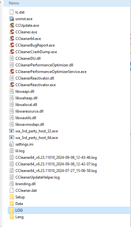

Whatever I try I cannot get CCleaner to create a file called āsettings.iniā.
I even went as far as installing the version from Microsoft Store as Iām aware that it creates some extra files.
So another question - If you look at the properties for that settings.ini file then on what date was it created?
(I seem to recall that the installer used to create a temporary file of that name - but that was over 10 years ago).

It may even be Nitnite that is creating that āsettings.iniā in the CCleaner folder for itās own use?

If you want your CCleaner settings to survive in-place reinstalls (and it seems updates from some update tools) then enable that āSave all settings to INI fileā option that I ringed in red above.

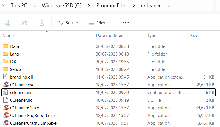

You have hit on something a bit weird alright. If I follow the āOpen file locationā from the start menu, it eventually points me to my custom install location D:\Program Files\CCleaner, however, when I checked the C drive equivalent, the ccleaner.ini file is there and has todayās date timestamp. I recall I did a reinstall at the request of the support team, so I wonder if I forgot to change it to D drive.
Anyways, I now have the ini file, so do you just copy this, install on the new laptop, select the check box to create the ini, overwrite this with the old one ? Or is there a way to āproperlyā import all the settings via this file ?
