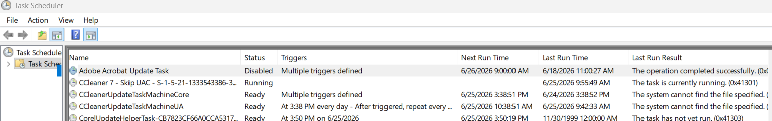

Task scheduler shows System cannot find file specified 0x80070002
theses are for update tasks. How to fix or can i delete?

Thanks for this screenshot @ADGORN,
R74DE is the File ID
status?

@ADGORN Our team has taken a look and the task you are seeing is to update CCleaner Browser.
The Task Scheduler entry is configured to run the CCleaner Browser update file at the following location:
C:\Program Files (x86)\CCleaner Browser\Update\CCleanerBrowserUpdate.exe

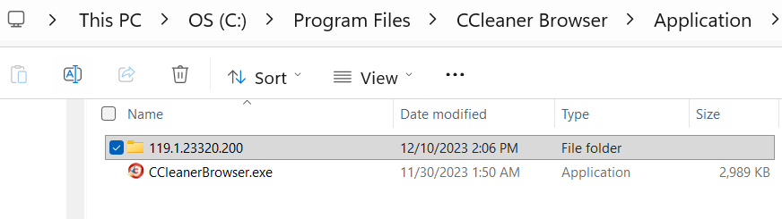

No, it is located here:
Thanks for this screenshot @ADGORN, the file we are asking about is CCleanerBrowserUpdate.exe and not CCleanerBrowser.exe. Please check the C:\Program Files (x86)\CCleaner Browser\Update for the CCleanerBrowserUpdate.exe file.
My bad, sorry. No, there is no such folder nor executable as the above in (x86).

Hate to argue, but you even posted an image of file explorer ccleaner browser.
