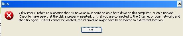

When I try to run C:\system32\dllcache
it says this
I can access my C drive, so I don't know why it's saying this?

I think you'll need to replace the "framedyn.dll" file first, but you ran Dial-A-Fix correctly.
From my post above:
C:\WINDOWS\system32\dllcache
Have a read here, and in the instructions the writer refers to "C:\system32\dllcache". That's wrong, the correct path is as shown just above, and you can simply amend that yourself.
You're getting that message because the instructions have the above error in them.
When it says to insert "C:\system32\dllcache", amend that manually to "C:\WINDOWS\system32\dllcache", minus the quotation marks. Or just copy and paste it from this post, and again, no quotation marks.
