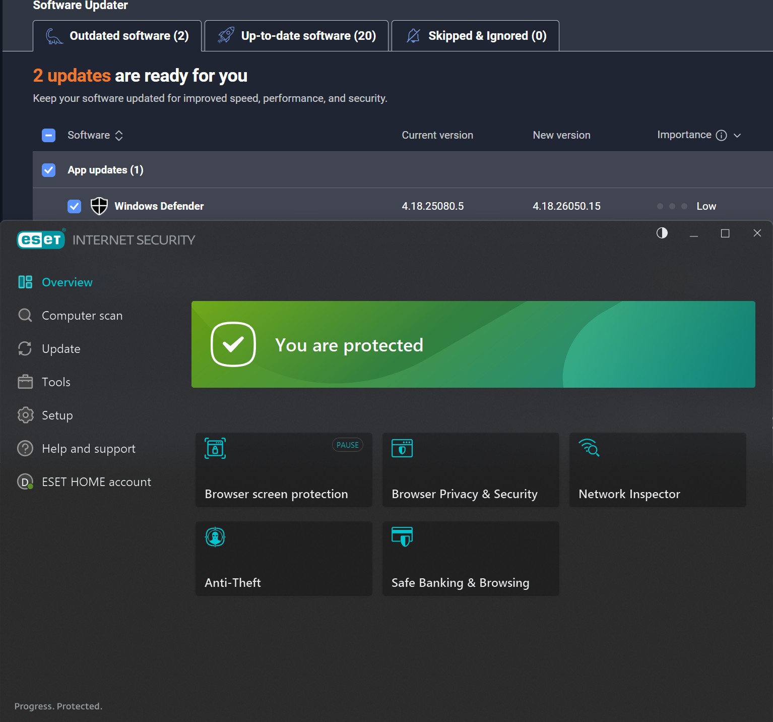

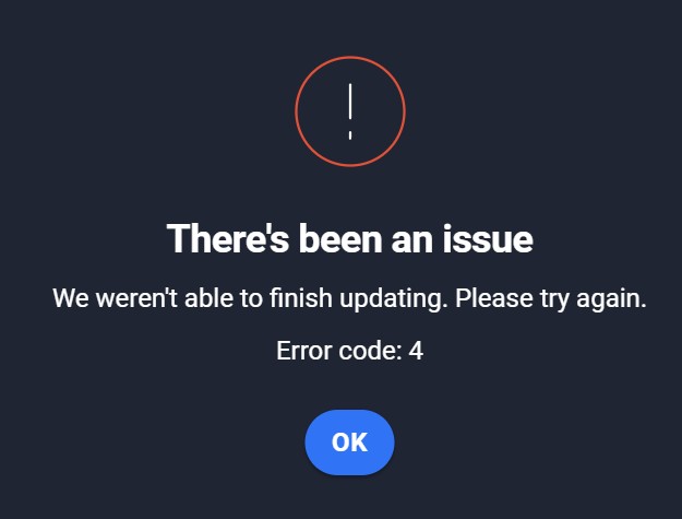

Software updater pushes Microsoft Defender Update while running ESET, Error Code 4
Hello:
You need your software updater to check for ESET before trying to push a Defender update. ESET disables defender and the installation will fail every time.
Since Microsoft Defender is correctly asleep while ESET is on duty, the Error Code: 4 panel belongs entirely to CCleaner’s background Software Updater engine.
Thank you!
Defender turns itself off when you install/enable any 3rd party AV.
(ESET does not “disable” Defender; Windows turns Defender off when it sees a 3rd party AV is enabled).
However even though Defender is not running Windows Update still updates Defender and it’s definitions.
This is done for two reasons:
  1. Defender will still perform regular scans even though it is not the ‘active’ AV, so it needs to be up to date.
  2. If/when you turn off the 3rd party AV then Defender will be up to date and Windows can turn it on to take over seamlessly.
And that is why CCleaner also offers Defender updates even when you don’t have defender running as your real-time AV.
As you note Error Code 4 is a CCleaner error code.
They don’t publish them, so I’m not sure what it means, but it isn’t because you have ESET.
PS. I personally do not believe that CCleaner should be offering any Windows Updates - Windows itself takes care of them as and when needed.
I suggest that you ignore them (untick them) when CCleaner offers them to you. That’s what I do.
Hi @Radon82,
We will be releasing CCleaner v7.9 soon. When this is available, please update and let me know if you are still experiencing this issue.
@nukecad v7.9 will have an option to ignore a currently offered update or skip all update offers, so you will no longer need to untick them, you can just set them to skip.
Hello sir, I was able to hide these issues with the new version. I really like this feature. Also just sharing the fact that this occurs. If there is another way to submit a suggestion or just share info let me know.

First off Thank you to @nukecad and @hazelnut. As we can see Defender has different behaviors in different scenarios. The real kicker is that CCleaner does not have the correct permissions to update the files while 3rd party AV has it in sleep mode. That was the original issue with the Code 4. The new option given by @Laurence_CCleaner is fantastic, it is like pinning an update in PowerShell hence giving the GUI the same benefit as a power user.
