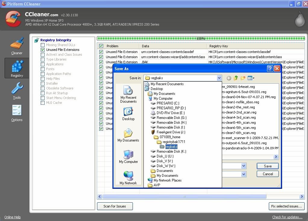

Here is a picture
shows me where I put the last CCleaner reg backup file. Should mention that I renamed them from the CCleaner Default. :)
