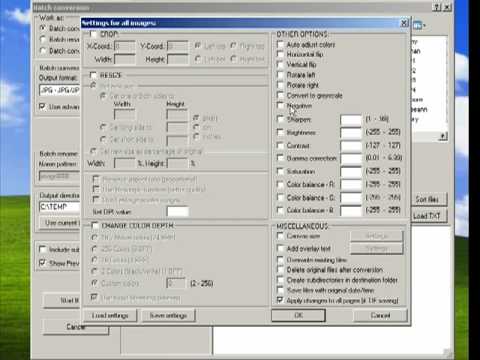

One thing that you might try is the batch conversion tool in Irfanview, (a ‘batch’ can be just one file) sometimes converting a problen file from a jpeg, png, img, or bmp format to one of the other formats can make the problem file openable.
I have used it a few times to repair files by batch converting them.
It is a very powerful tool with a lot of options, but the basics are fairly easy to grasp:
