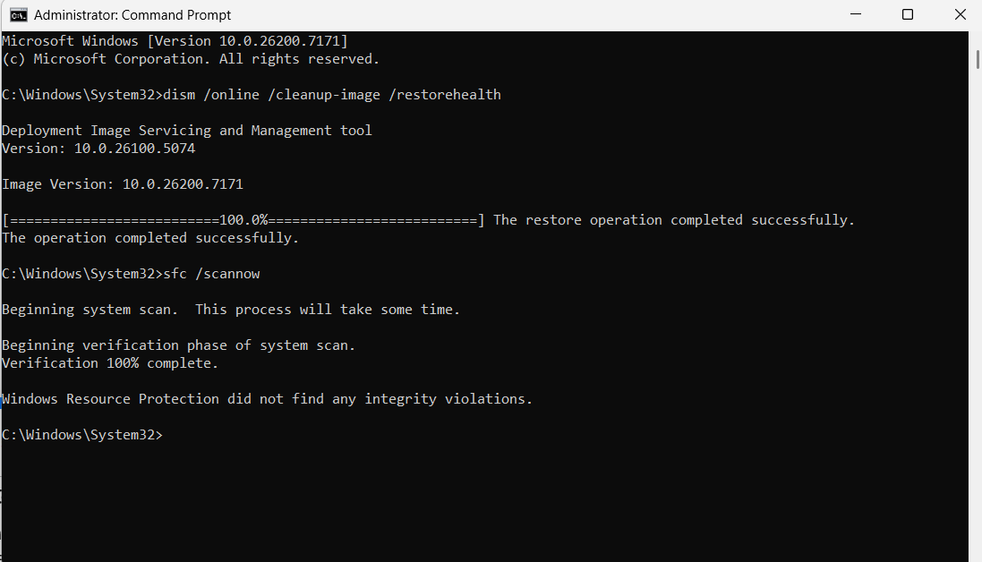

Firstly check, and if needed repair, the system files using DISM and SFC.
Everybody with a Windows computer should learn how to do this, it’s the first things that you do to fix a problem computer (many do it once a month or even once a week just to check their system files are OK):
Note that with Windows 11 the DISM may appear to get stuck at 62.3%.
It isn’t stuck it is just taking a long time with certain files, let it continue and it will suddenly jump up to 100%.
However if it does go ‘busy’ at 62.3% then it can take up to 20 minutes on a decent speed machine, and it can be an hour or two on a slower machine.
You can keep using the computer for other things while DISM is churning away at 62.3%.
Once DISM has completed you then run SFC to check the System files and repair them if needed.
Here it wasn’t needed:
If SFC does find and repair errors then Restart your machine and run just SFC /scannow again (no need for another DISM).
Keep doing that until SFC no longer finds any errors which shows that your System files are good.
