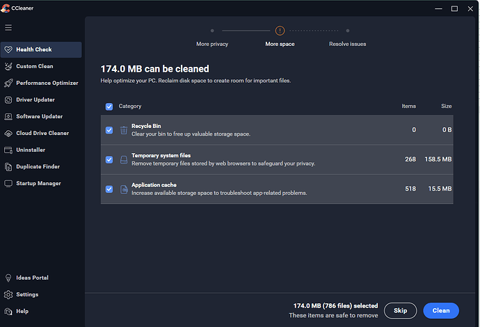

Did you put the apps to sleep with performance optimizer
The only way that this could happen is if you blindly clicked clean on the second
and third (resolve)
and blindly did performance opt as stated above

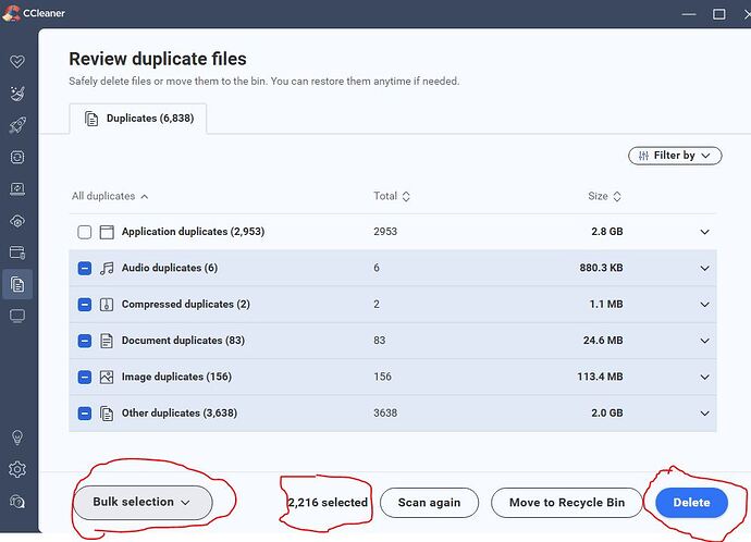

I’m assuming that it went like this:
  1. You used CCleaner7’s Duplicate Finder to search for duplicates on all drives (not in a specific folder) - and so CCleaner7 found ALL the duplicate files on your machine.
  2. Then on the ‘Review Files’ screen you haven’t reviewed anything but just used the ‘Bulk Selection’ option to select all files, or the older or newer duplicates.
  3. And then you clicked the blue button and deleted EVERYTHING that you had Bulk Selected.
If you tell CCleaner to delete every duplicate file then it will delete every duplicate file.
What you should have done is just search for your own files, not for every duplicate file on the drives.
Windows and installed apps need some duplicate files to work properly - if you remove those System and App duplicates then they will stop working.
As you have already found out. (I am somewhat surprised that you have apparently done the same thing three times - surely once was enough to tell you that you were doing something wrong?).

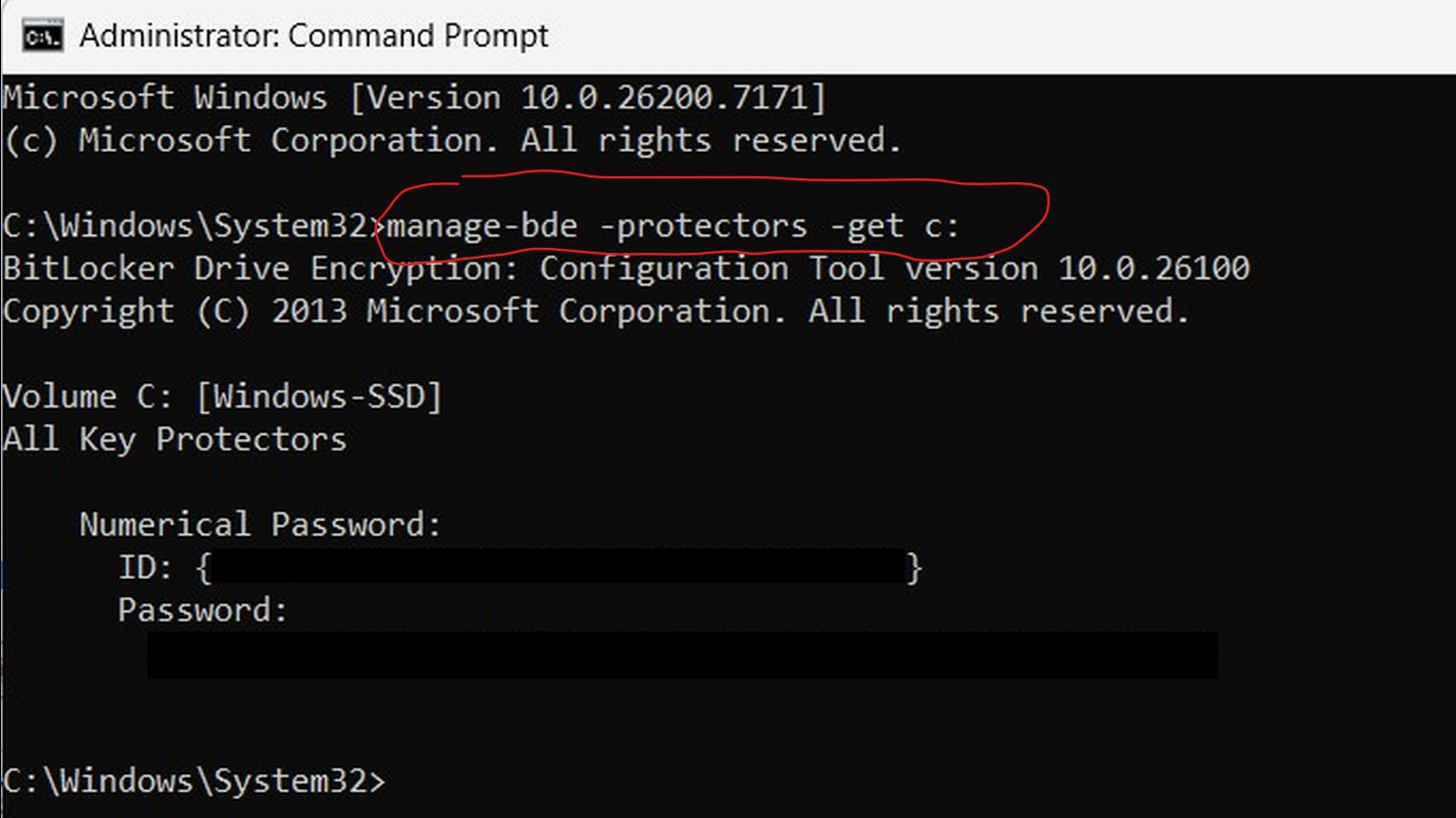

PS. For those who can still access their computers - Check and make a note of your bitlocker key NOW, you never know when you might need it:
  1. Open an elevated Command Prompt: (Open the Start menu and type: cmd it will show you Command Prompt, select ‘Run as Administrator’).
  2. Type in: manage-bde -protectors -get c:
    (You can change the “c:” to a different drive letter if it is a different drive that you want the Bitlocker key for, but your boot drive is usually 'c:")
  3. The 48-digit recovery key will be displayed on your screen. (Obviously I’ve removed mine here:
  4. Copy and store the recovery key somewhere off the computer, keep it safe.
