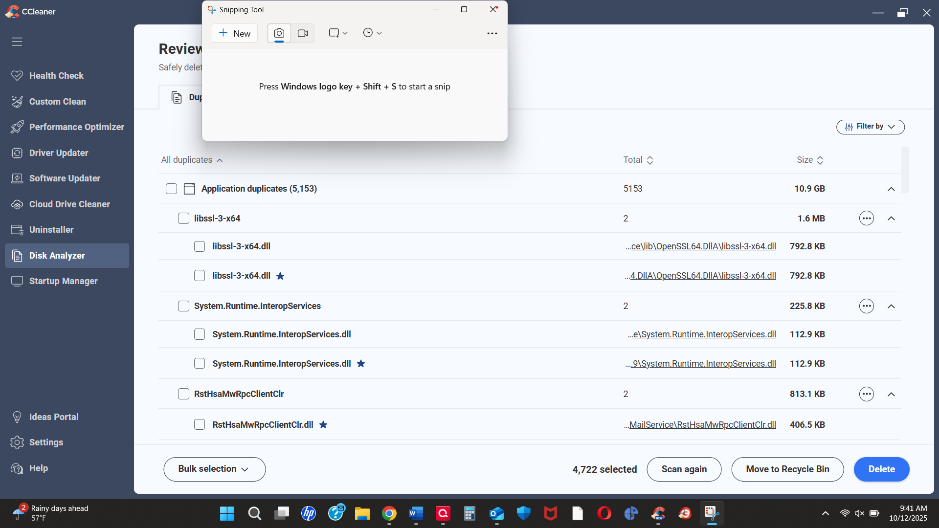

Thanks, I can see the blue stars in the new v7 duplicate finder, and the files do indeed appear to be system files.

I read the file deletion warning.
My mistake, now I’m blue starred out, maybe I should of waited, even read more of the instructions before deleting files.
No more dependent on the blue star for duplicate files deletion, there is no recovery for those lost files.
Now that I lost MS Word it looks like I have to purchase one when I was grandfathered years ago, “my loss of access to Microsoft Word may be due to an older, one-time purchase license conflict.
MS anything isnt helping me with the key recovery, its a mess again.
When I rebooted after each deletion ran the programs the system was running faster and responsive.
I thought to keep going thats when the egg hits the floor and inevitable failure that follows it.

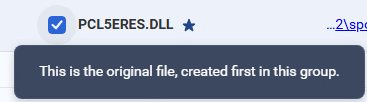

If you hover over the blue star, the tool tip shows that the files indicated with a blue star are the original file.
So the blues star does not indicate a system file.
A good example of why you shouldn’t trust what a browser AI tells you.
