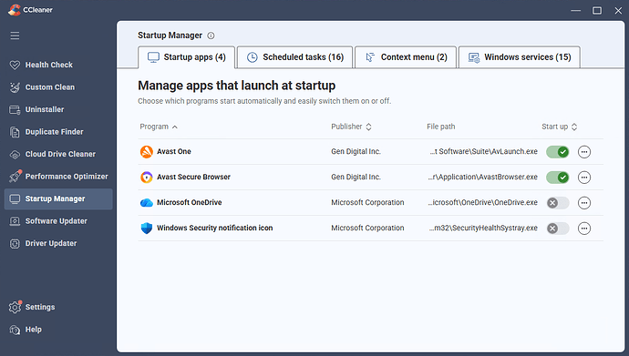

@Mejjo Do you have Windows Security notification icon disabled under Startup Manager?
If so please enable this and let me know if this resolves the issue?
Hi @Laurence_CCleaner
Yes i do have this showing as enabled already

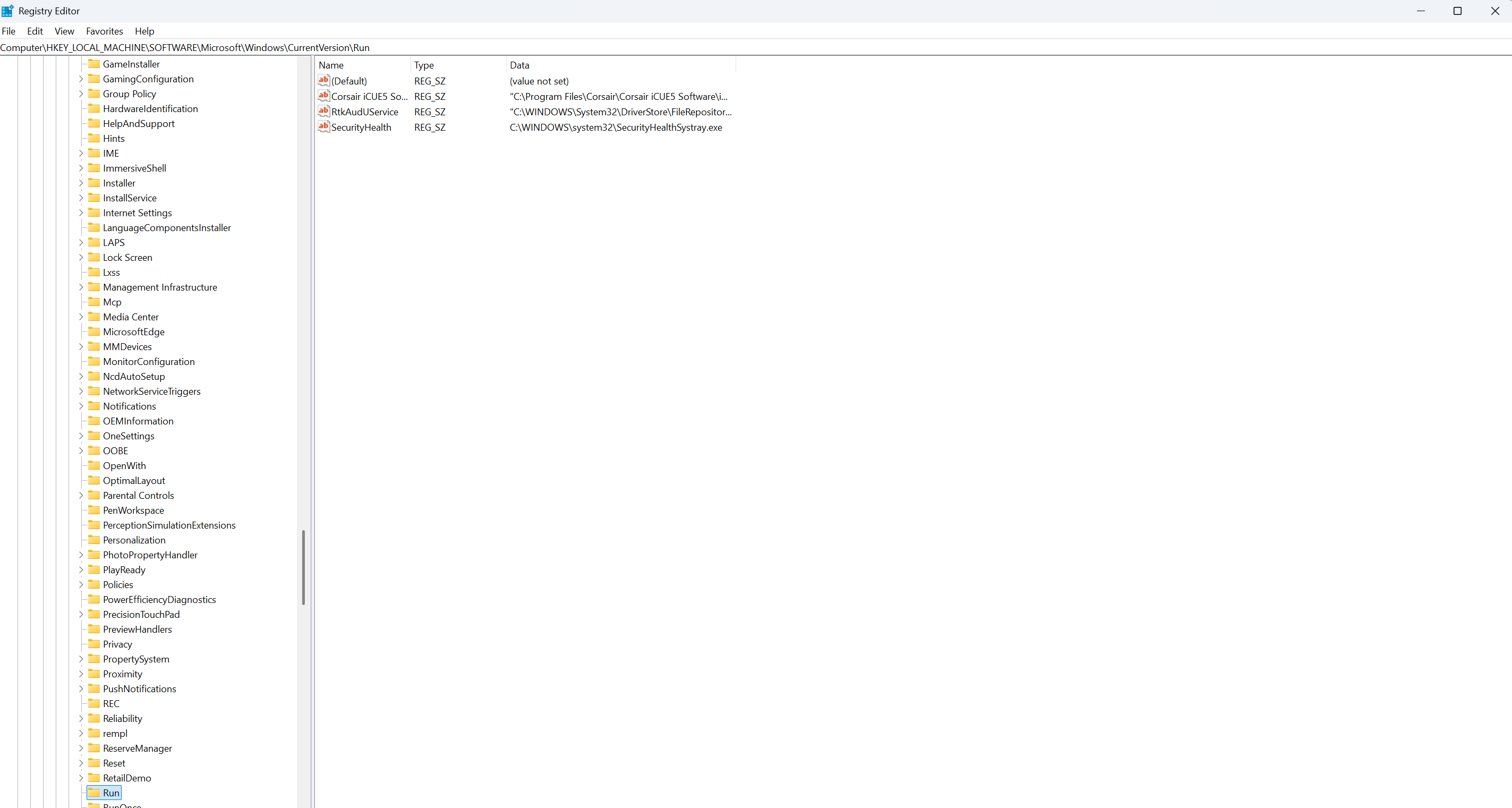

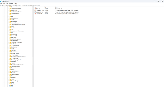

Please can you click the three dots to the right of Windows Security Notification icon and select Open in RegEdit and send me a screenshot of what you see.
@Laurence_CCleaner No problem at all, I will add the image here.

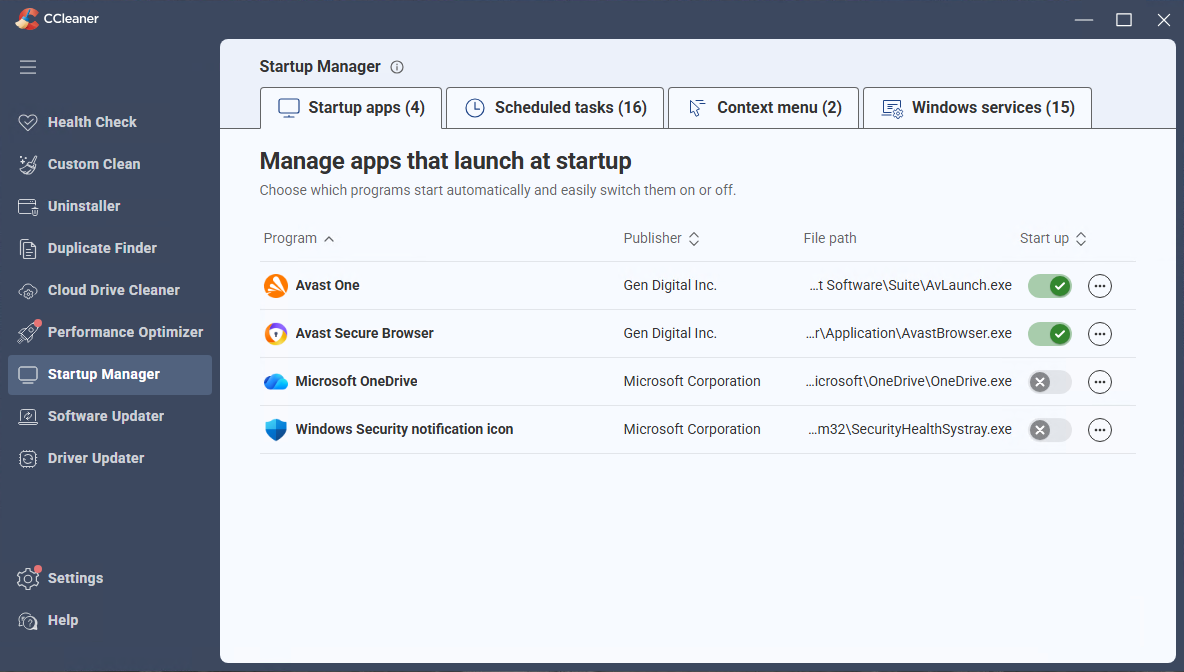

Thanks @Mejjo, could you try to disable the Windows Security notification icon option in Startup manager, reboot your PC then reenable the option and let me now if after another reboot the issue is resolved?
Hi @Laurence_CCleaner Unfortunately this did not make any difference and the icon does not appear unless i go to run and run C:\Windows\System32\SecurityHealthSystray.exe

@Mejjo, we have made an update on the server side of CCleaner. Please let me know if you are still experiencing the issue?
@Laurence_CCleaner hi thank you for the update
Unfortunately this has made no difference my end. I have tried to disable / enable the icon in startup manager again to see if the update made a difference when trying that, but sadly it hasn’t.
