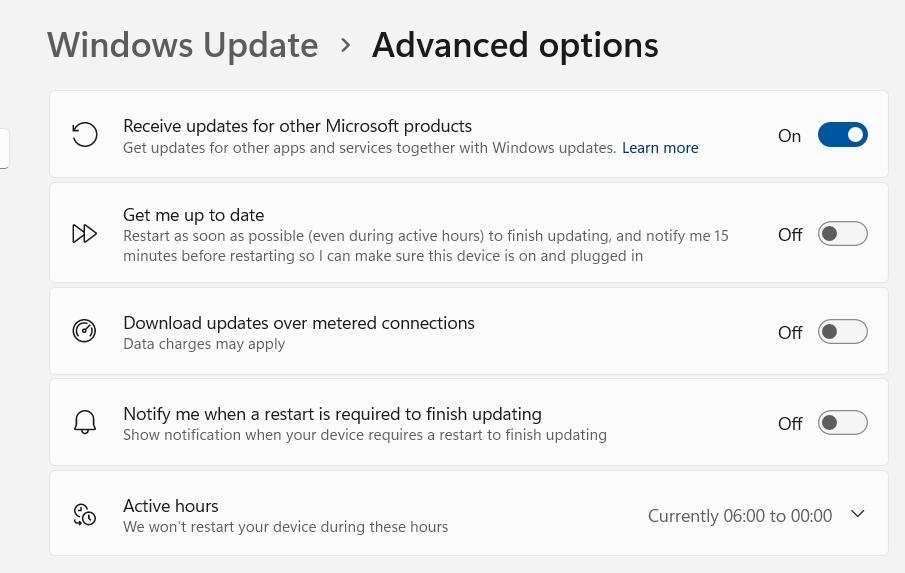

If using ‘Check for Updates’ then make sure that you have ‘Receive updates for other Microsoft products’ selected in the Advanced options (it’s usually a good idea to have it on always) this is from Win 11 but it’s similar in Win 10:
